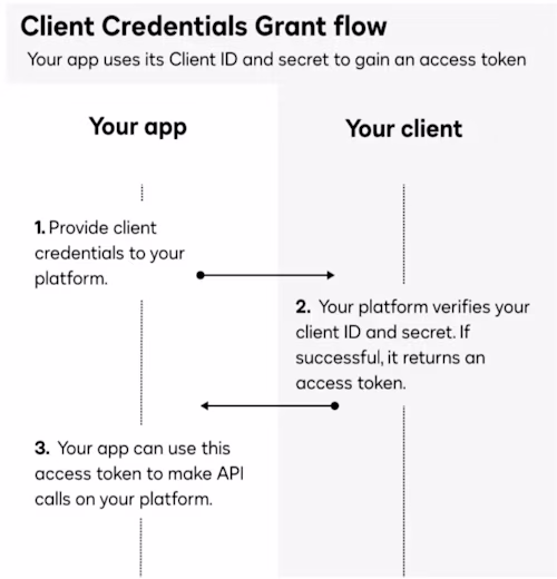

The Client Credentials Grant allows private extension apps to exchange a client ID and secret for an access token. Designed for automated, server-to-server processes, this flow requires no user interaction and is intended for shared admin use within a single organization.
