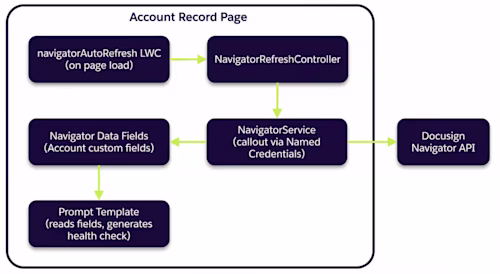

System architecture for agreement health checks
The system has five components, each with a single responsibility. This separation matters for testability—you can unit-test the service class independently of the parsing logic—and for reuse, since the service class works for any Agreement Manager endpoint, not just agreements.
1. NavigatorService: A reusable Apex class that handles all HTTP callouts to the Agreement Manager API via Named Credentials. This is the secure communication layer.
2. NavigatorRefreshController: An @AuraEnabled controller that calls the service, parses the JSON response, and writes structured data into custom fields on the Account. This is the sync engine.
3. navigatorAutoRefresh LWC: A headless Lightning Web Component placed on the Account record page that checks whether data is stale and triggers a refresh only when needed. This is the automation layer.
4. NavigatorHealthCheck: An @InvocableMethod class that Agentforce can call to fetch and store Agreement Manager data. This is the AI bridge.
5. Account Agreement Health Check Prompt Template: A Flex prompt template that reads the structured Account fields and generates an AI-powered health check. This is the AI instruction set.

To keep Agreement Manager data fresh without manual intervention, we create a headless LWC that sits on the Account record page. It has no visible UI — it just checks whether the data is stale and triggers a refresh if needed.
The “check-before-sync” pattern here is important for system reliability. Rather than firing a callout on every page load, the LWC reads the Navigator_Last_Synced__c timestamp and only calls the API if the data is older than one hour. This prevents excessive API calls in high-traffic orgs where many users view the same Account throughout the day.
force-app/main/default/lwc/navigatorAutoRefresh/navigatorAutoRefresh.js
import { LightningElement, api, wire } from 'lwc';
import { getRecord } from 'lightning/uiRecordApi';
import refreshNavigatorData from '@salesforce/apex/NavigatorRefreshController.refreshNavigatorData';
const FIELDS = ['Account.Navigator_Last_Synced__c'];
const REFRESH_INTERVAL_MS = 3600000; // 1 hour
export default class NavigatorAutoRefresh extends LightningElement {
    @api recordId;
    _hasRefreshed = false;
    @wire(getRecord, { recordId: '$recordId', fields: FIELDS })
    handleRecord({ data }) {
        if (data && !this._hasRefreshed) {
            const lastSynced = data.fields.Navigator_Last_Synced__c.value;
            const now = Date.now();
            const lastSyncedTime = lastSynced ? new Date(lastSynced).getTime() : 0;
            if (now - lastSyncedTime > REFRESH_INTERVAL_MS) {
                this._hasRefreshed = true;
                refreshNavigatorData({ accountId: this.recordId })
                    .then(() => {
                        console.log('Navigator data refreshed for account: ' + this.recordId);
                    .catch(error => {
                        console.error('Navigator refresh failed:', error);
force-app/main/default/lwc/navigatorAutoRefresh/navigatorAutoRefresh.html
<template></template>
force-app/main/default/lwc/navigatorAutoRefresh/navigatorAutoRefresh.js-meta.xml

Rate limits: Docusign APIs enforce per-account hourly rate limits (returned in the X-RateLimit-Limit response header). The one-hour interval in REFRESH_INTERVAL_MS is a conservative default — adjust it based on your org's traffic and API allocation. In orgs with hundreds of users, you may want to increase this to 4–8 hours or move to a scheduled batch job instead.
Adding the component to the account page
  1. Navigate to any Account record in Salesforce.
  2. Click the gear icon and select Edit Page to open Lightning App Builder.
  3. Find Agreement Manager Auto Refresh in the component panel on the left.
  4. Drag it anywhere on the page (it renders nothing visible).
  5. Save and activate the page.
Step 5: Create the Agentforce invocable action
To make this data actionable for AI, you need an @InvocableMethod class that Agentforce can call. This class receives the Account record as input, calls the Agreement Manager API, and stores the raw JSON on the Account for the Prompt Template to use.

Requirements for the invocable method
  • The input class must have a field named RelatedEntity of the sObject type matching the template’s related entity (here, Account).
  • The output class must have a field named Prompt of type String. This is the required output variable for Prompt Builder integration.
  • The callout=true attribute is required because the method makes HTTP callouts.
  • No CapabilityType attribute is needed. After deploying, you’ll add this class as a resource in Prompt Builder directly.
Step 6: Create the Prompt Template
The prompt template is a Flex type (einstein_gpt__flex) template that reads the structured Account fields populated by the refresh controller. Because the data is already parsed into clean fields, the LLM receives well-structured input and produces reliable, grounded output.
force-app/main/default/genAiPromptTemplates/Account_Agreement_Health_Check.genAiPromptTemplate-meta.xml

Full deployment
Because we no longer use CapabilityType, the deployment order is simpler — there's no circular dependency to work around:

Next steps
You now have a working data pipeline from Agreement Manager into Salesforce, with AI-powered health checks on top. Here are some ways to extend it:
Add a scheduled batch job: Replace or supplement the LWC with a Schedulable Apex class that syncs all Accounts nightly, reducing reliance on page-load triggers.
Build a renewal workflow: Use the Navigator_Expiring_Soon__c field to trigger a Flow that creates renewal Opportunities automatically.
Extend to other objects: The same pattern works for syncing Agreement Manager data to Opportunities, Contacts, or custom objects.
Add the getAgreement endpoint: NavigatorService.getAgreementById() is already in the service class. Build a detail view that shows full agreement provisions when a user clicks into a specific agreement.
