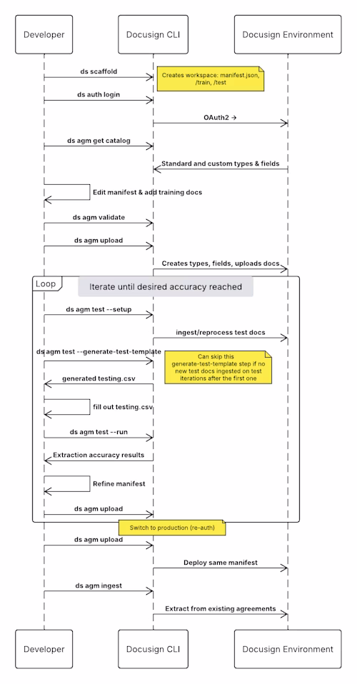

The first-time workflow is:
  1. Install the CLI and create a workspace.
  2. Authenticate to your developer account.
  3. Retrieve the account’s existing catalog.
  4. Define custom agreement types and fields in the manifest.
  5. Add training documents and upload the configuration.
  6. Test extractions against expected values.
  7. Update the manifest and retest as needed.
  8. Upload the validated configuration to production.

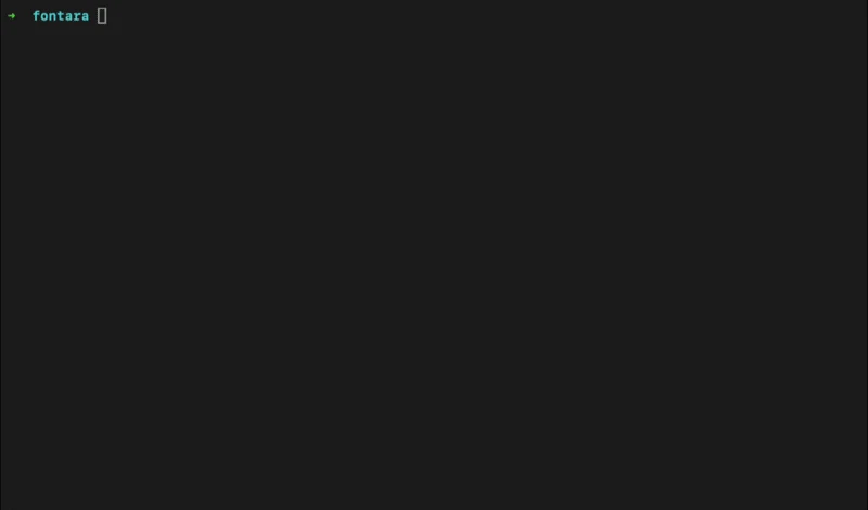

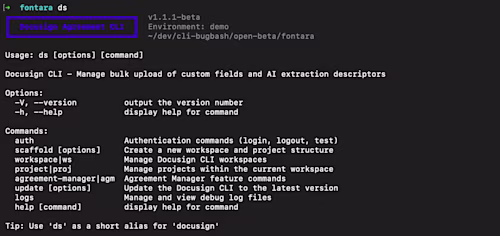

Confirm the installation succeeded by running the root command:
ds
If the CLI is installed, you will see help output listing the available commands.

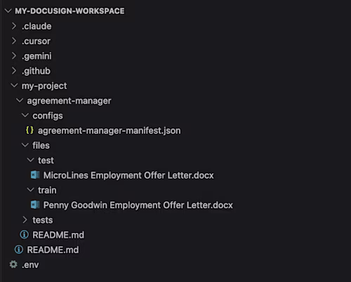

ds scaffold -w my-docusign-workspace -p my-project -f agreement-manager
This creates a workspace at ./my-docusign-workspace/ with the following structure:
  .env
  my-project/
    agreement-manager/
      configs/
        agreement-manager-manifest.json
      tests/
      files/
        train/
        test/
      README.md

Step 4: Test extractions against expected values
Before uploading the configuration to production, compare the extracted values with a set of values you know to be correct from your own agreements.
The test workflow has four main stages:
  1. Ingest or reprocess test agreements
  2. Generate a test template from a set of agreements.
  3. Enter the expected values in the generated CSV file.
  4. Run the test and review the results.

Optional: Run extraction tests as a repeatable job
The CLI commands are scriptable, so you can use them in a recurring test job or a partially automated CI workflow. However, the current OAuth flow still requires a user to authenticate. Fully unattended CI without a human sign-in step is not yet supported.
A typical repeatable test workflow is:
  1. Authenticate to the developer environment or use a stored token.
  2. Upload the current manifest version.
  3. Run ds agm test --generate-test-template to upload the test agreements and generate the CSV.
  4. Populate the CSV with expected values, or use a ground-truth file already stored in the repository.
  5. Run ds agm test --run.
  6. Parse the output CSV files and compare the field-level results with your accuracy threshold.
  7. Fail the job if accuracy falls below the threshold.
For headless environments such as SSH sessions or containers, authenticate with:
ds auth login --no-browser
The CLI prints a login URL that you can open on another device. After signing in, paste the redirected URL back into the CLI so it can exchange the authorization code for a token.
This supports test runs from a headless environment after a user authenticates, but it does not remove the human login step.
