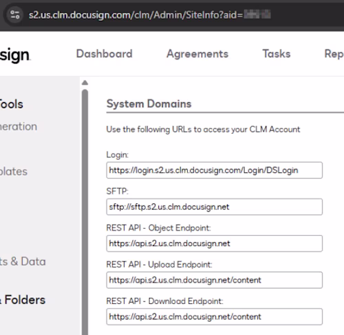

        For CLM accounts that have migrated to Azure, the base URL has changed. Please refer to our support page for the latest Azure migration schedule and details.
        Pre-migration
        • Upload: https://apiupload{datacenter}.springcm.com
        • Download: https://apidownload{datacenter}.springcm.com
        Post-migration (Azure)
        Upload and download:
        • Production: https://api.{site}.{region}.clm.docusign.net/content
        • Developer: https://api.{site}.{region}.clm.demo.docusign.net/content
        You can see here that the post-migration URL is the same for both download and upload. For the examples in this article, we will use the post-migration Azure base URL.
