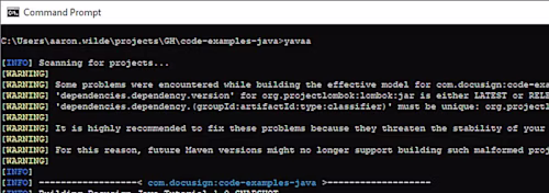

    So now, what is in this beloved Yavaa.bat file? A tidy mix of Maven opens in a new tab commands that I like to run in a sequence each time. That sequence goes: shutdown server, cleanup, compile, restart. This workflow has given me the cleanest results in terms of making iterative changes and seeing their effect when working with a Java environment and not wanting to context-switch or remember "where is the compile button?". This has just become a second-nature habit of mine to type in 'yavaa' when I'm ready to test the code, and it's instant.
    Here are the contents of my Yavaa.bat file:
    @echo off
    echo.
    mvn spring-boot:stop clean package spring-boot:start
    That may seem complex, so let's digest it all. The first line, @echo off, will turn off repeating the command to the user, so they won't see the script say maven spring-boot… each time I run it. The second line, echo., will print a blank line. The last line of the script is a condensed Maven one-liner to stop, clean, package (recompile), then start the server. I can execute this command inside a command-line terminal for my language IDE, such as IntelliJ. Since it’s Maven, I need to make sure that the directory I'm working in has a Maven POM opens in a new tab configuration and its required files, or else I'll run into errors.

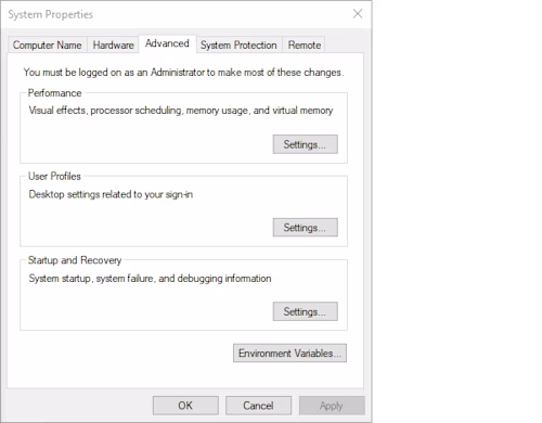

    When using Windows, you need to have means by which to fire the script anywhere, and I mean anywhere! First, save the Yavaa.bat script in a descriptive folder location. For mine, I've named the folder "alias" and parked it at the root of the "C:" drive. You can then add your folder to the Windows Path variable. To do so, use Windows search to find "Edit the system environment variables". Clicking the result opens the System Properties control panel. Select "Environment Variables" at the bottom, then edit the Path variable in the SystemVariables list.
    Once you’ve set this up, you can use your alias folder to store different batch scripts to automate tasks. Some other examples of automation include combining a lint/cleanup tool for your code and pushing the changes to a branch on git, all within one command, or using different scripts that can call from other scripts to make difficult tasks easier. Here's what I do to kick off a build for my Java projects:
